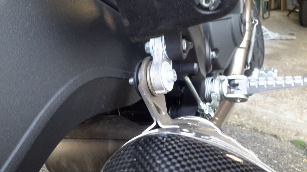

Here are all the mounts from mine
Jerry,
That's interesting, yours is the first one I've seen with the pipe mounted to the inside of the "dog bone".
Neither way looks spot on to me, yours is pushing the dog bone out so it's under pressure, mounting the pipe to the outside means the pipe mount is too close to the hangar. I used a grinder to trim the top of the pipe mount to give it more clearance.

I thought that and why I asked Jerry for pics as I had no instructions. His one doesn't use both large black rubber bushes and the original Ducati video shows it as I had it but it obviously sits out further than Jerrys and his bolt look close to the swingarm. I wait for further news or photo copy of the install guide paperwork.

I installed mine a couple of days ago and also went for the mount inside the dog bone as there's no way to fit it on the outside without grinding away some bits and the install set up fit like a glove and didn't look awkward at all despite my expectations from this thread.

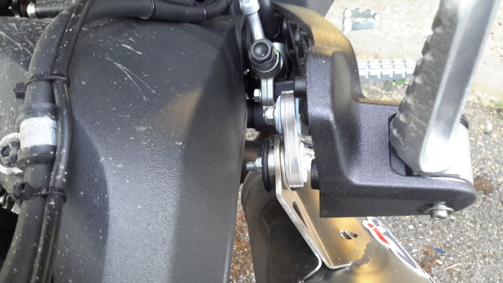

This was agreed at my dealer today to be correct and is as close as possible to the image at factory video. Uses all the rubber washers correctly but rather than cutting bracket down with a grinder or wearing footrest hanger I since took photo have made a 3mm aluminium washer and 5mm longer bolt. It clears both elements and is sturdy and safe and looks correct. Its up to you how you fit yours but dealers are not getting fitting details either so far.

Thanks for all the info and pics Albie; I've had another go at mine and now it's in front of the mount and seems better but who knows...hard to tell when there's at least 10 bits and pieces left in the box when you're done mounting the exhaust! I seem to have a spare spring, a spare dog bone with not 2 but 4 blue rubber bushes, a bunch of washers, etc... I'd this ever happen to my ikea furniture I'd be super worried, but in the spirit of ducati and all Italians I'll just go grab a coffee and enjoy the beautiful sound the bike makes!
