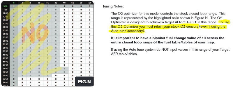

  • adjusting the fuel trim value
    • Scrambler uses closed loop with 2 lambas. "Fuel trim" is only for open loop. Not an option here.
