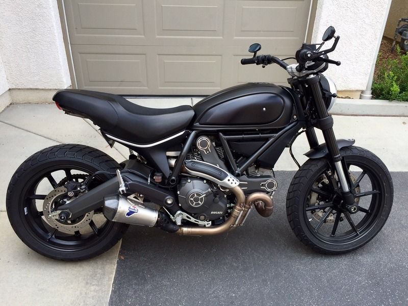

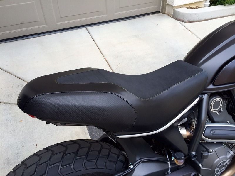

48 Posts
Someone on the forums cut out the little tool case on their Comfort seat and said that removing that hard lump made a HUGE difference in the comfort of even that seat. You can definitely see how that hump in the base rides up and takes away any room for cushioning. Makes the Corbin seat, with its flatter pan, look really good.
57 Posts
Had my seat redone. Had the seat moved back 1" so I'm sitting further back. Added softer foam for a cushier ride. Dyed the yellow threads black and replaced the yellow with carbon fiber. Rides awesome and looks a million times better as I couldn't stand the yellow.
