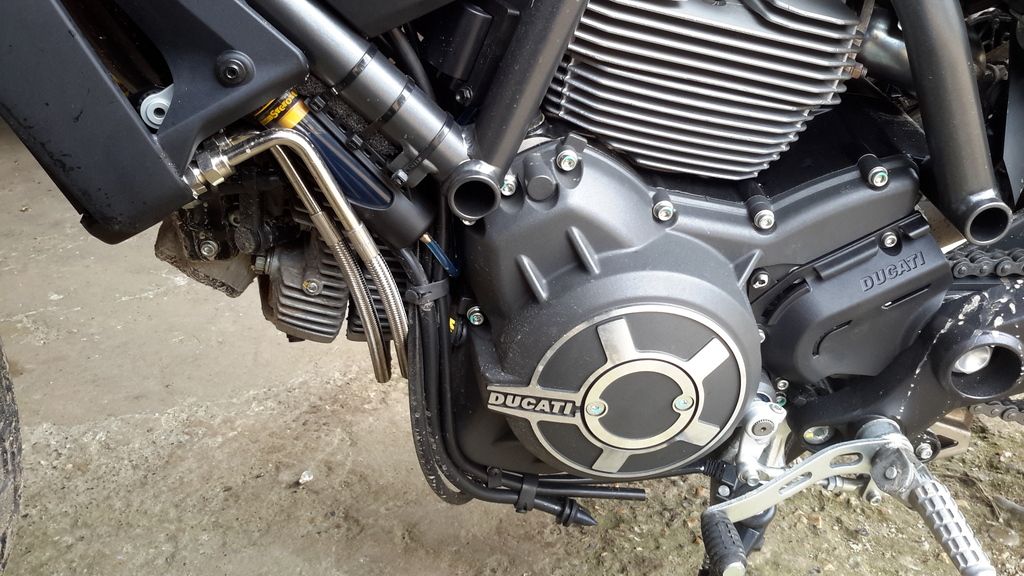

Mine is here
Just pull the plunger every couple of hundred kilometers. Not too conspicuous I think. At first the tube ran from the reservoir on the inside of the frame which was even less visible but I had some leaks so they rerouted the tube like this.

I like the way Jerry has his albeit as he says awkward to top up but hidden from general view. Is there anyway of fitting under the seat in that box for the PHONE to rattle around in. I do notice this bikes chain gets more abuse than my Monster did as it gets used more often in any weather. Mine needs a clean before weekend. I need to investigate scottoiler or an alternative very soon.
I do wonder why Asador mechanics couldn't fix the leak and why its on the wrong side of the bike now. :( Still it works and that matters more than anything.
